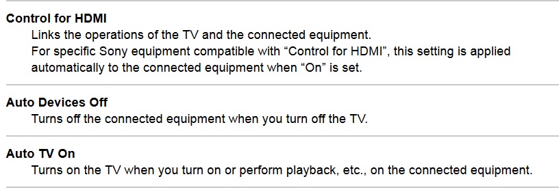

Looking at the HDMI settings - Even IF the PC was compatible for HDMI-CEC functions (Bravia Sync) which it probably isnt, there is still no way to switch the TV off. You are able to have the TV switch itself on via a compatible connected device, but not the other way around.
Your only option is the Idle TV standby setting/presence sensor (if available) but they have some drawbacks if used too.
