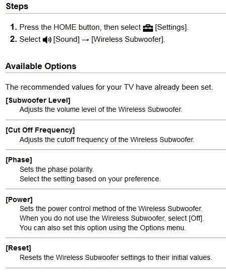

Also, have a look at these settings on the TV and ensure that the levels are correct:

Hi
I have done all the above and also tested on another Sony bravia tv
