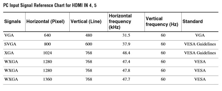

If your having problems receiving a signal from your PC, you need to change the display (resolution) settings on the PC, to one that is compatible with your TV. See table below:
