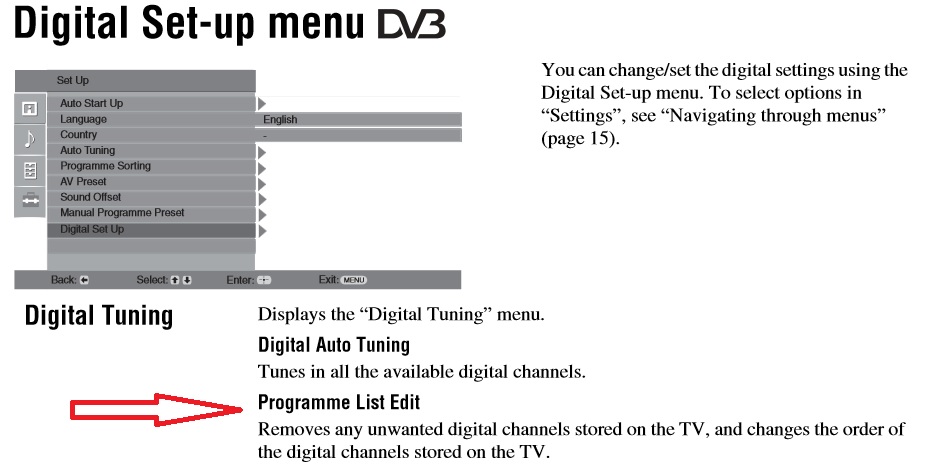

Im only going on a couple of assumptions here though.  You said in a previous post that you think the problem lies in one or more of the channels in the 50's range.  There are only 2 channels in the 50's range that "could" cause issues.  These are the BT Sports channels, of which you cannot access without a decoder box anyhow.  Therefore if you delete those channels, it may fix your issues.
To delete channels:
  1. Press the [Menu] button on the remote control.
  2. Scroll down to "Settings" and press [OK]
  3. Scroll down to "Digital Setup" and press [OK]
  4. *Note* this is where instructions are unclear - Find a menu called "Program List Edit" or "Programme Sorting"  From there, you should be able to delete certain channels, follow on-screen instructions.
Except from manual:
undefined
Hopefully this helps
