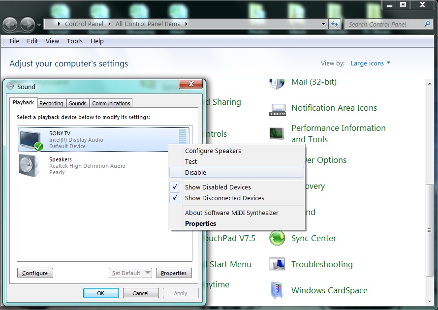

Hi there
Ensure that the Sound settings on the PC is actually outputting audio via coax/audio out. Similar (but not exact - as this is for HDMI) to the screenshot below:

My current audio playback is set to Realtek HD Audio output already...

By disabling the DVI in the Sound/Audio section of the control panel?
or....
There might be a Audio section in your graphics card software? Or whatever display adapter you are using?
Baring in mind that some modern graphics cards can output audio via DVI connection, so dont get mixed up between the two when searching around (googling)
