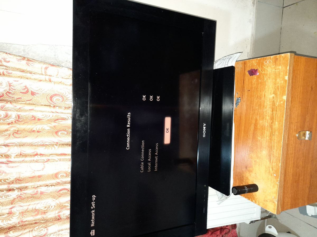

My sony kdl-32cx523 is not getting connected yo internet eventhought network results for all 3 shows OK
Afyer setting up wifi through usb extender with lan cable i refresh internet content and i get error of 2206 or 1106 everytime. And when i click wireless setup it shows device not compatible (means usb extender not compatible) I even tried to do manual ip address but of no use. If all setting are ok through wired connection why wireless option shows incompatible device inserted Can someone please help me

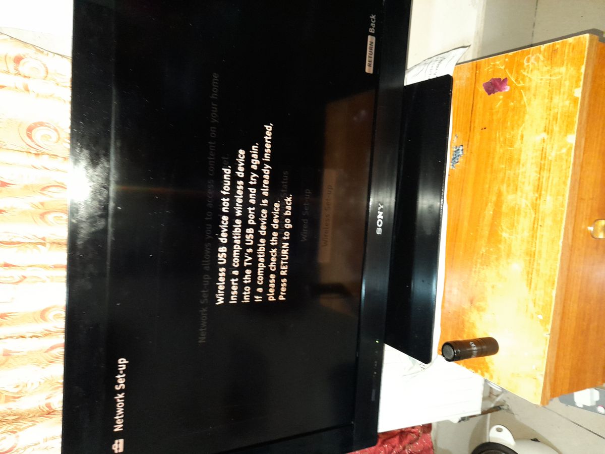

Thats right i got it from ebay for 14£ (Adapter For Sony UWA-BR100 HDTV In Dual-frequency USB Fast 300M Wireless) pix-link company brand ans aper sony instruction i did wired set up as well everything shows fine cable connection OK loical access OK network access Ok. After that when i go for wireless setup it showsme insert usb wireless device and if its inserted please check its compatible device. And when i go for refresf internet connection gives me error of 2200 sometimes and sometime1606 displated.

As I have said a couple of times above, and as Sony’s own instructions, which I quoted, describe, you need to go for the wired setup on the TV at this point.
This is because the device, despite actually using WiFi (which you set up only on the device itself) pretends to the TV to be a wired Ethernet cable, and so the connection needs to be set up on the TV as wired.

I have done wired as well after that as well it showing all OK but when i go for wireless set up it says insert device (which means usb adapter br100) or check if its compatible device same error i jst cant go to the wireless setup until.and unless it shows compatible device i cant believe that usb port has got issue because i got my pendrive with some files where it shows all the file so its fine jist if i am not wrong the one which i got usb adapter is a faulty but if its faulty then how can i connected through wired setup and showed me cable connection ok local access ok netwrok set up ok just in wireless i cant get through. I have sent u pic as well

DO NOT ATTEMPT A WIRELESS SETUP ON THE TV WITH THIS DEVICE.
A WIRELESS SETUP WILL NOT WORK WITH THIS DEVICE.
INSTEAD, DO A WIRED SETUP ON THE TV WITH THIS DEVICE.
PICTURE 2, DO NOT TAKE THE OPTION YOU HAVE HIGHLIGHTED. TAKE THE OPTION ABOVE IT, WIRED.
A WIRED SETUP ON THE TV WILL WORK* WITH THIS DEVICE.
THE DEVICE DOES ACTUALLY USE WIRELESS, BUT ONLY WHEN TALKING TO THE ROUTER, NOT WHEN TALKING TO THE TV, WHICH IT FOOLS INTO THINKING IT IS A WIRED DEVICE, AND SO THE TV MUST BE SET UP ACCORDINGLY. AS A WIRED DEVICE.
THE DEVICE YOU HAVE CAN REPLACE A BR100, BUT IT IS NOT A BR100, AND IT OPERATES DIFFERENTLY FROM A BR100, AND IT NEEDS TO BE SET UP A DIFFERENT WAY FROM A BR100.
SET IT UP ON THE TV AS A WIRED CONNECTION. WIRED. DID I SAY WIRED? WIRED.
NOT WIRELESS. WIRED.
*To be exact, while a WIRED setup on the TV is the only thing that will work, you still may get this wrong, and have it not work initially; but if so keep trying.
So, what’s happening here? Well your device faces two ways. To the router it behaves as a wireless device - and you will have set up its wireless accordingly - but to the TV it behaves as a wired device. The TV can’t access the wireless bit of the device, which is why you keep getting errors trying this. The TV can only talk to it as a wired device; and when you set it up as this, all should go fine, as the device works its magic of turning wired into wireless further inside itself, where the TV can’t see.
And there is nothing wrong with your device, and nothing wrong with your USB port, it seems. Just wrong thinking that you can set up a wireless connection on the TV with this device, which doesn’t present itself to the TV that way, and so you can’t, and you have to use Wired setup on the TV.
