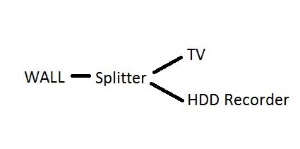

Can you test both aerial cables individually? From Wall to TV. Also, have a look at the signal strength and quality, to see if one cable is significantly worse than the other. Now if they both work fine, you could try to use an aerial splitter, to feed each aerial cable to TV and RDR-DC205 individually. Thats how I have mine set up actually.
I dont have your model HDD recorder, I have the SVR-HDT500 one, and have it as follows
