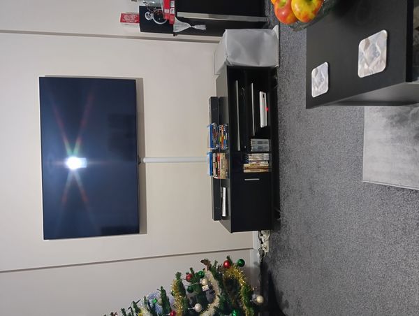

Hi,
I will just repeat my ealier post from 2020:
"I found the problem myself. At my place this was a case of overheating.
I moved the player to a cooler place and the problem was solved.
My old sony blu ray was fine at the first location, but this one wasn't."
I have not had problems since, so I am quiet sure this is the solution. The player needs a much cooler location than my old Sony player.
Merry X-mas!
