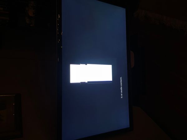

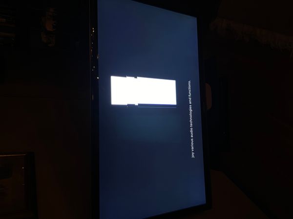

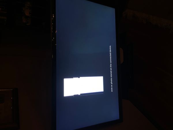

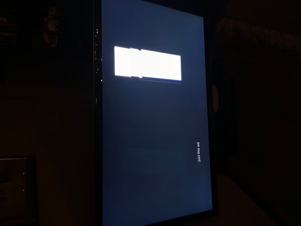

Im just experiencing the same problem but way worse. can see that im navigating the menu but I can't get any information out of it.
thank u for replying!
