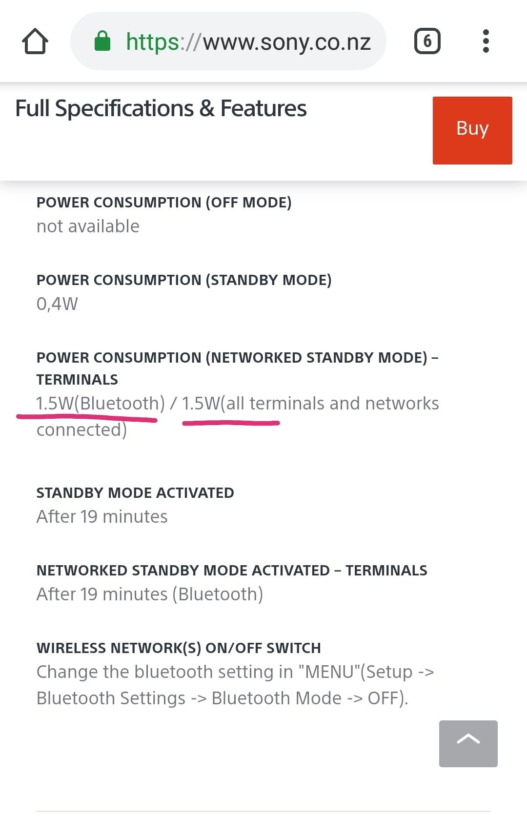

59 watts in standby mode, wow! My APAC region model uses 31w to 35w with Network Standby enabled. Alot higher than the advertised 1.5w (now removed from the Sony website):

"Not within parameters" is in my opinion, quite an understatement; the specifications on any European site still states the 0,4 w consumption on standby and 1,5w on network-standby as opposed to my device using 59w!
