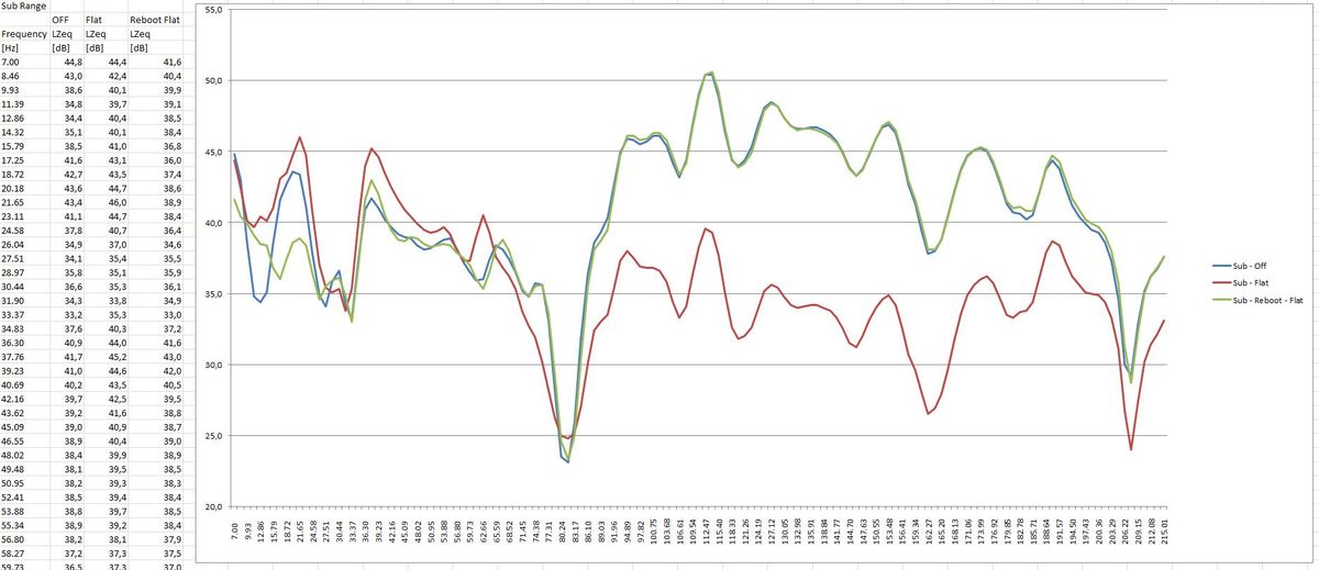

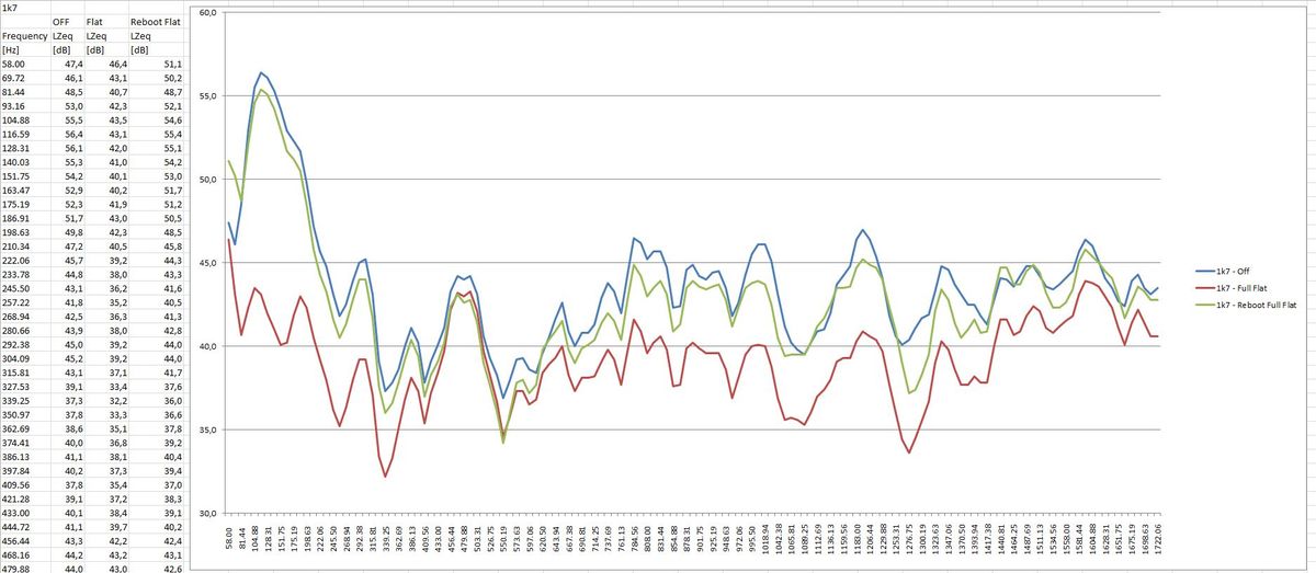

Here are the latest measurements after "clearing" for three different frequency ranges.
Blue line = "Off".
Red line = "Full flat" prior to reboot.
Green line = "Full flat" after reboot.
7Hz to 215Hz
58Hz to 1722Hz
484Hz to 20453Hz
Hi Ben and Philippe,
First off, thank you both for following up on my request to perform a measurement test after clearing up the device. I truly appreciate that, as that helps ruling out any coincidental malfunction. I also had a detailed look at the results posted by Philippe and can clearly say that it doesn't look good at all. Your device fails post a power cycle to retain the calibration mode profiles. So I don't see any reason why your device would not require a repair service. You are obviously entitled to a full functioning device.
