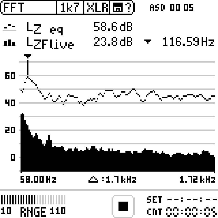

Here are the results for the low frequency room response, using a sine sweep tone.
1. Room calibration set to "Off". There's a peak at 116,59 Hz. This should be addressed by applying the room correction.
2. Room calibration set to "Full Flat". The 116,59Hz peak has indeed been corrected in "Full Flat" mode. One can hear that veryl clearly when listening to music or test signals (sine tones, pink noise, etc.).
3. After a unit reboot, "Full Flat" is still shown in the room calibration mode. However, it sounds like "Off" and the measurement is also exactly as in "Off" mode. The detected peak is again at exactly the same frequency as in "Off" mode, namely 116,59Hz.

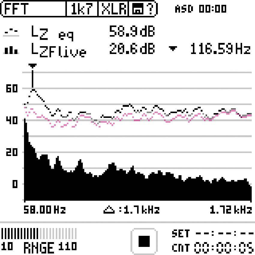

4. Here is an overlay of both measurements: "Off" is black and "Full Flat" is red. You can clearly see how effective the correction is.
5. Here's an overlay of "Off" (black) and "Full Flat" (blue) after a unit reboot. Even though the unit says it is using "Full Flat", it does not. The line is nearly identical to "Off" mode.
