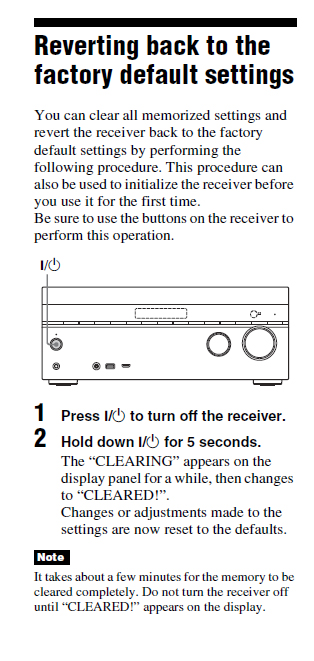

Have you tried resetting the receiver, that sometimes helps?

Thanks no that didn't work, I just had to set everything up again, but the AMP button on the remote still doesn't do what it's supposed to do.
