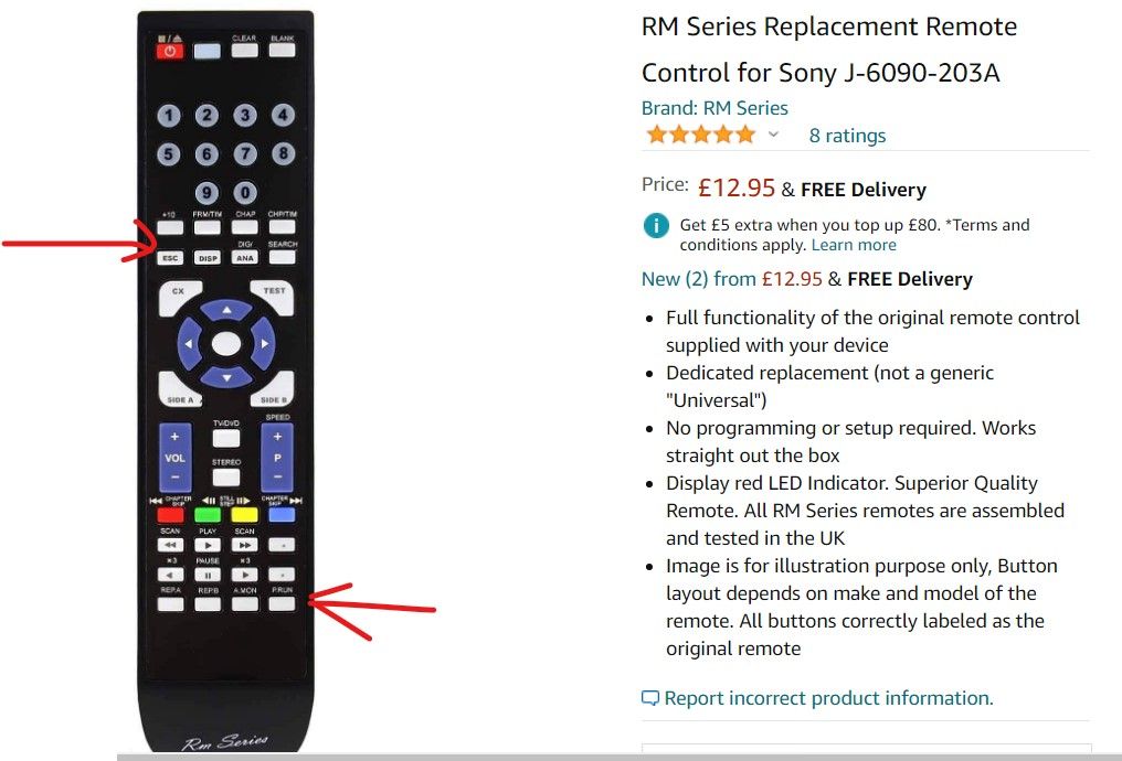

You need the service remote, there is no other way to do this. The good news is that there are some universal remotes for sale that work well. I bought one of these in 2016 and it seems they are still available. You need to be sure that the remote has the buttons 'ESC' and 'PRun'.
https://www.amazon.co.uk/gp/product/B00D3MX81A/ref=ppx_yo_dt_b_asin_title_o00_s00?ie=UTF8&psc=1
1/ With the replacement HDD fitted apply mains to the recorder and press the front power on button. You will see error code E01.
2/ Turn off with the front panel button.
3/ Now press ESC on the remote followed by PRun (press one after the other, not together).
4/ Formatting begins. WAIT until 'B Complete' shows on the display. This may take up to 10 minutes.
5/ Switch on with the front power button... and that's it.
Note... some HDD's are more suited to this than others. What you want is a drive designed for continuous data flow rather than a supposed high speed drive. Speed is not important, steady read and write is. Use what you have but if you experience any freezing etc then look for a more suitable drive. Toshiba drives gave problems for me. The Seagate 'Pipeline' drives (back in 2016/17) with their lower than usual spindle speed are optimised for this type of use and have proved superb in daily use.

Hey, the compatible remotes are (RMT-D248P) & (RMT-D250P). Try searching online for those first although I doubt they might be still available (Who knows \ ._. /
The steps for the format are on the manual page 128: https://www.sony.com/electronics/support/res/manuals/3113/31137601M.pdf
