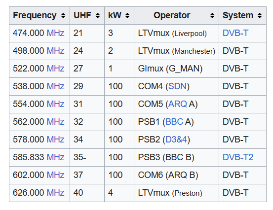

Winter Hill is Group A now after moving from group C/D. CH24 is also Group A so you have a problem. I wonder how Sony conclude that something on CH24 is an issue.
Looking back on the thread I and see yours is not an HXD-870 so there may be some differences in the menus but I would recommend you look at the 'signal strength' option and manually enter CH24 and see if any signal shows up. It should NOT for Winter Hill. You should see signal on channels 29, 31, 32, 34, 37 and 40. Chanel 37 may be at a lower level.

I actually get great signal strength 100% on Ch 24 ( That's 80s TV Channel).
I also pick up channel 27, good signal strength 94% (great TV +1) not on your list.
29,31,32,34,37 all 100% signal strength
It's channel 40 the only channel where I get zero % no signal strength or signal quality

I also pick up channel 21 (liverpool TV )93 % signal strength
Channels 21, 24 and 27 are very low power local relays. You can see the difference in transmitted power here, between 1 and 3 kW vs 100kW for the main multiplexes.
Did you ever try the attenuators ? Given that the local channels are so far down in power I would have thought you could kill the signal for those with a simple attenuator while leaving the main ones still at a good level. Even if only as a test to see if what Sony say works.
You will find the Sony works fine even down to low signal levels and so attenuating to bring the main ones down to say 70% should totally remove the others. An 18db attenuator will drop the level (the signal voltage) by 87.5% and a 24db by 94%
Attenuators can be stacked and the values simply add. So a 15db and 6db give 21db overall. I can't really think of anything else easy to try.
(Those are massively high attenuation levels but even my loft aerial will stand 18db attenuation)

I never tried the attenuator -so which one should I try say 6db?
I think you will need way more than 6db tbh. 6db would only half the signal level. Remember they can stacked so a 6 and 12db also makes an 18db equivalent. Given your 94% and 100% levels for all channels I'd bet you need at least 18db, maybe more.
Another thought... too much signal generally can cause big problems with some equipment and it may be that more modest attenuation helps. I'm struggling to see what/why Sony think this one channel is causing problem tbh.
You can only try them.
