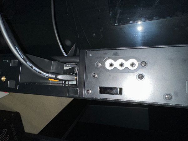

I used screened 3.5mm jack stereo cables from DelayCON the longest at 15 meters.
And some Maxhood flat right angle 3.5mm jack connectors (as my soundbar is wall mounted and the jack points and on the rear of the soundbar).
To find the jack points on the sound bar they are behind a sticker on left rear with 2 screws on either side, simply peal off the sticker to reveal 3 female 3.5mm jack points for Sub, rear left and rear right.
The jack point on the sub is under the power button under a sticker.
The jack point on the rear speakers is on the right hand on the rear of the speaker in a vertical recess with a sticker to remove, this is quite tricky to get off.
Wire in all the cables then power off all the wireless speakers and power them back on, the link light will turn to orange (wired) and never drop out again.

I've just come across your thread, and would be interested to know exactly where the port is on the sound bar unit (I tried one sticker and it seemed like a service port). Would you be able to post a photo? Prefer not to start digging around for anything that seems like a sticker!

Hi, I just found out about this and was able to remove the stickers as well, and I got you with the picture, but I’d also like to point out that a bluetooth transmitter workaround is a terrible idea since those bluetooth rear speakers will 100% lag behind compared to the rest of the system. It’s just the way Bluetooth is. You’re better off purchasing the official ones.

i just picked up this thread because I’m having the same issue. Would you mind posting a photo of the location of the Jack on the subwoofer please? There’s a bit of plastic that I may be able to force off but I don’t want to do any damage so I want to be sure it’s the right place.

Hi, here you go
