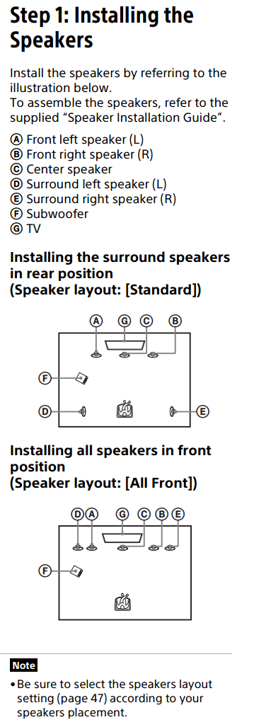

The symptoms you describe would indicate that you have connected your speaker wires incorrectly. Please check these on page 16 of the user manual found here: Manual
I notice on page 16 it also refers to 'Connecting the Speakers' on page 21
Here's what it says:
Given that these wires are colour coded I can't imagine you would get that wrong however I wonder if all the plugs 'clicked' when inserting them?
Please also check you have set the correct 'speaker layout' as described below
If all connections are correct please also refer to the 'Troubleshooting' tips on pages 69 - 70 in the above manual.
