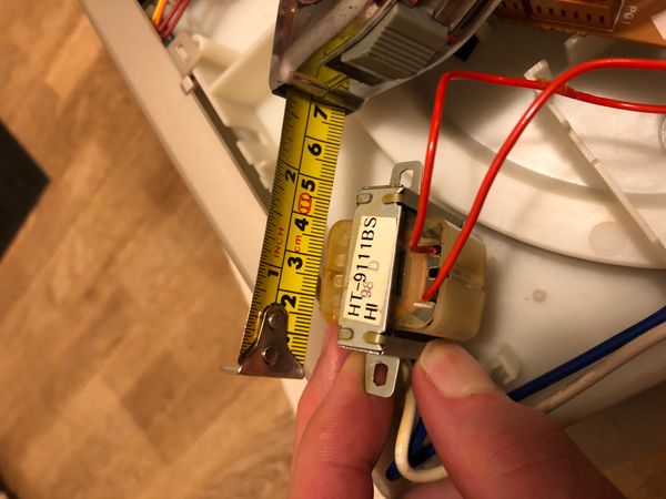

Having trouble sourcing a replacement transformer for this ps J10 turntable that has died (primary coil is open circuit).
I can’t find anything that tells me the spec but I assume it’s 12v as the motor is 12v.
Serial number search on the pic below produces nothing.
any help would be much appreciated

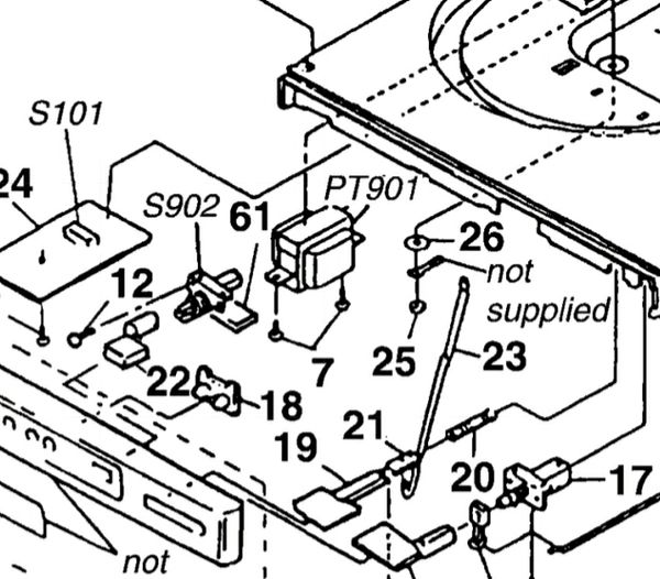

PT901 1-427-716-11 TRANSFORMER, POWER (AEP,UK)
Perfect - that leads to a full schematic of the machine with parts list of every component.
one thing missing is voltages / current across the transformer.
anybody fill that in for me?
