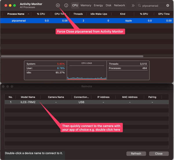

I have another potential workaround that's working for me where none of the others above were:
Before attempting to connect to the camera (from Imaging Edge Desktop, Zoom, Teams etc), force stop the ptpcamerad process. In my case, this system daemon appeared to be using the camera and preventing other apps connecting. The steps to do this are:
With luck, the app can now connect. And, on my machine, so long as the camera remains on, apps can reconnect to it without needing to do the same trick every time. The OS appears to restart the ptpcamerad process within a second or two. I'm not sure what impact killing this process might have on other apps so do this at your own risk!
This solved it for me! Thank you so much... now to that Zoom meeting
I just had the same problem and after some testing I think I found a workaround.
First I installed https://github.com/dognotdog/ptpwebcam which is able to access the camera without any problems. (It should already make it available for some apps, but because some codesigning issues it doesnt work for some apps without modifying the app itself.)
Then I killed the ptpcamera process as described in a post before and suddenly my camera started to work through Imaging Edge.
