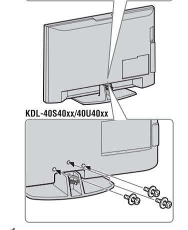

Are we talking about detaching the TV from the Theatre Stand if so there should be a strap that holds the TV to the Stand held on by two screws, these should be clearly visible at the back of the TV and Theatre Stand.
Or are you referring to removing the TVs own table top stand from the TV itself.

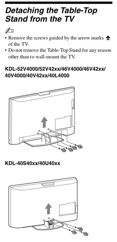

I downloaded the Operating Instructions dated 24/11/2009.
Scroll down to page 4 and there is a graphic showing you where the three screw holes are that attach the table
top stand to the TV. Page 8 is entitled Detaching the table top TV stand from the TV.
See below.

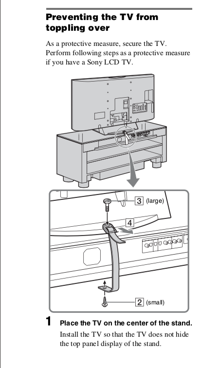

Are you sure the TV stand is attached through the glass top, there does not seem to be anything in the manual discussing this. The only thing I can find is the section where they describe preventing the TV from toppling over
and that is using the strap attached to the Theatre Stand and the base of the TV stand.
See image attached at the bottom of this post.
