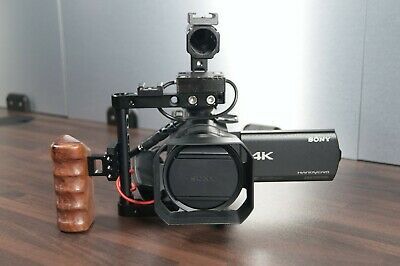

I recently purchased a Sony FDR AX700 and would like to use a top handle in order to capture angles (I film a lot with skating and cars).
My initial plan was to simply buy a top handle that connects via the Hotshoe on top of the camera, yet I'm skeptical if the weight of the camera (plus some of the accessories I plan to add) will be able to be supported by the small connection.
Does anyone have experience with a top handle for FDR cameras and has a more stable solution?

Hi @240ian,
I had both my FDR-AX100 (sold it a few weeks ago) and my FDR-AX100 in a camera cage usually meant for DSLR cameras.
That way the structure is supported by a base plate beneath the camcorders quarter inch thread, which means the top handle doesn't "rip" out of the camera (at least for me it didn't in 3 years of use).
Since I recently sold it I have some nice pictures of my former AX100, yet the cage is the same on my AX700 (just one part is turned 180 degrees.
I used the following parts from the brand "Camvate":
Cage: https://www.amazon.de/gp/aw/d/B06XDHMT33
Side grip (the one included with the cage is not very good and has "play"): https://www.amazon.de/gp/aw/d/B074V4JCYL
Adapter for the MI-Shoe: https://www.amazon.de/gp/aw/d/B00PE3XOZQ
