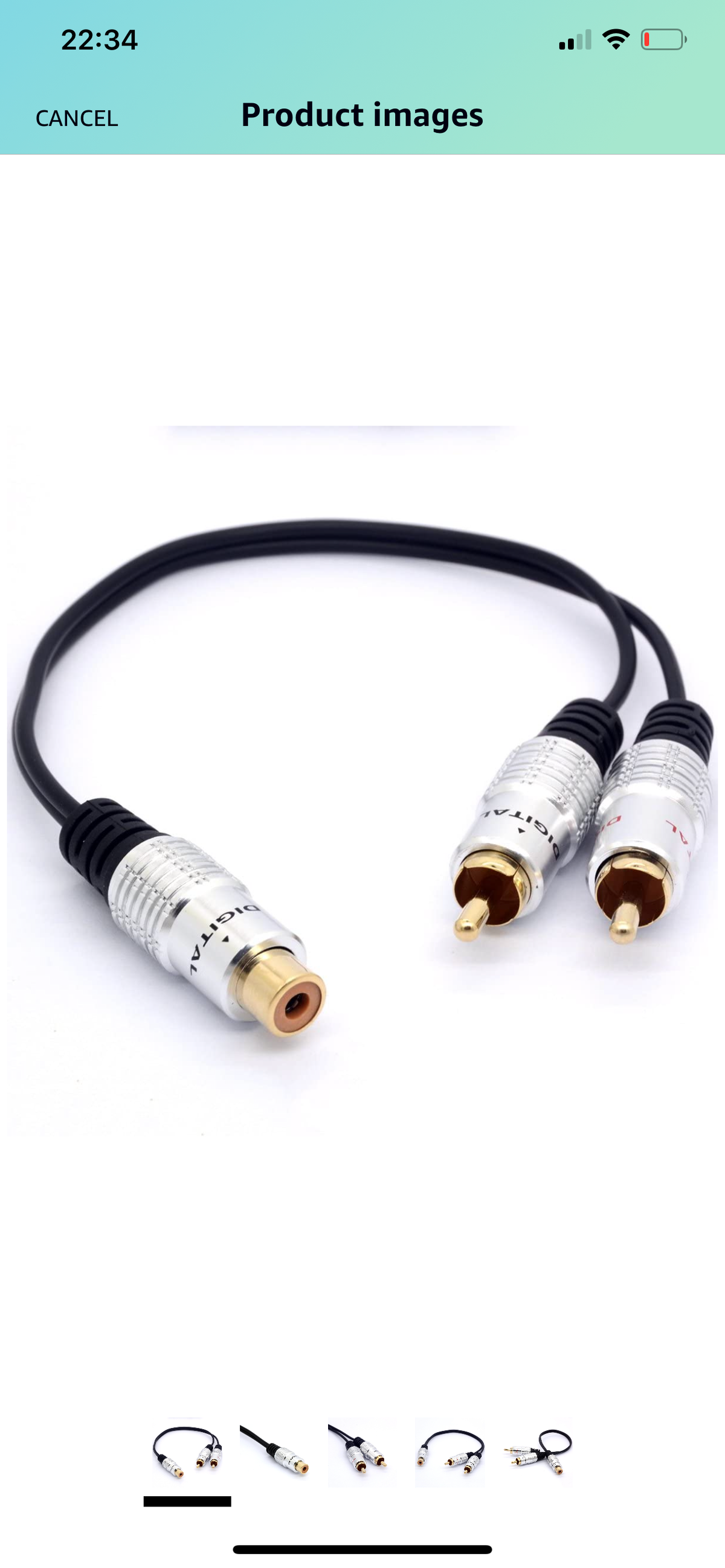

I guess you will need a 1x Female to 2x Male splitter for the audio. Or you may get by with just connecting to the red and ignoring the white.
