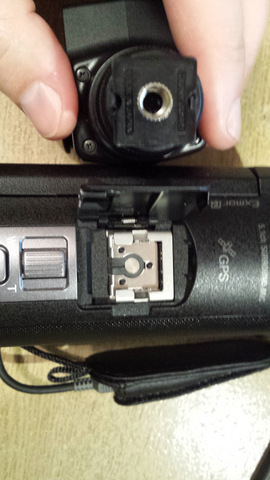

I have a new Sony HDR-CX410 handycam and have purchased the external microphone ECM-CG50 specifically for it. It is the high quality microphone I want and the compatibility list for the ECM-CG50 microphone specifies the HDR-CX410 camcorder as being compatible.
However it seems it is not compatible. The microphone holder that came with the ECM-CG50 does not fit in the accessory shoe on the camcorder, and neither does the adapter that came with the microphone.
How can I attach this microphone to sit securely on top of the camcorder? Or are they just not compatible at all...?

I've just purchased the CG50 mike for my cx410 and have the same problem.
Even without the adapter, it wont attach to the hotshoe

I ordered the JJC MSA 2 adapter off ebay, but that didn't work either.
I then tried cutting a bit off the bottom of the microphone, and that seemed to do the trick. Not really ideal, and will probably invalidate any warrenty, but if nothing else works
I have exactly the same issue with an FDR-AX100 trying to attach a ECM-CG50 shotgun mike.
The hot shoe on top of the camera is recessed and there is insufficient room around it within the recess to allow one to physically mount the mike.

Looking at the mic mount it is for standard hotshoe as fitted to some Videcams and digital SLRs and the Sony Multi Interface shoe as shown here.
Your cameras have the Active Shoe Interface which is different from the MI shoe.

Been looking up on it & found this:
Its called the "Sony Multi-Interface Shoe Adapter" it adapts from Multi-Interfact Shoe to Auto-lock shoe.
http://www.bhphotovideo.com/c/product/913654-REG/sony_adpmaa_multi_interface_shoe_adapter.html
