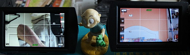

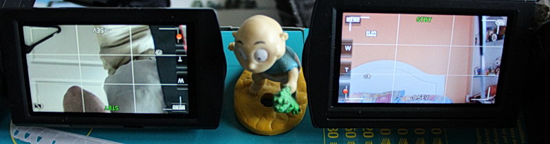

Let's see if this works, 4 images of the monitor screens side by side at identical angles
Top photo taken from behind the camcorders and the monitors are facing what I call "forwards".
Second photo I change my angle by standing up and monitors slightly forward.
Third photo and more or less straight on to monitor.
Fourth photo and monitors "backwards".
Hopefully now you can see why I say the LCDseems to be wrong way up. The 3rd & 4th photos are probably the usual angle I would have the monitor at, perfect on the 410 but becoming useless on the 620.

Take a look at the following, I've found a way to get the same brightness on the monitors at all angles:-
So, if you look at the above images you will see that one camcorder is facing forwards & the other backwards. The brightness of the display is about the same BUT to get that the 620 monitor is now upside down.
To me, it proves that compared to the 410 the 620 LCD is upside down. Is it a faulty batch or are they all the same?

From your photos there does look like there is a problem,
but its hard to say if its a batch or an individual item problem.
If I were you I would get the refund and try a different model.

To all who read this, I've provided information and illustrations to show you how the monitor screen appears when you are using, or trying to use the camcorder. Imagine what it is like when you are trying to avoid the bright sky reflections, you angle the screen down but the subject you are trying to film gets too dark to see it clearly.
