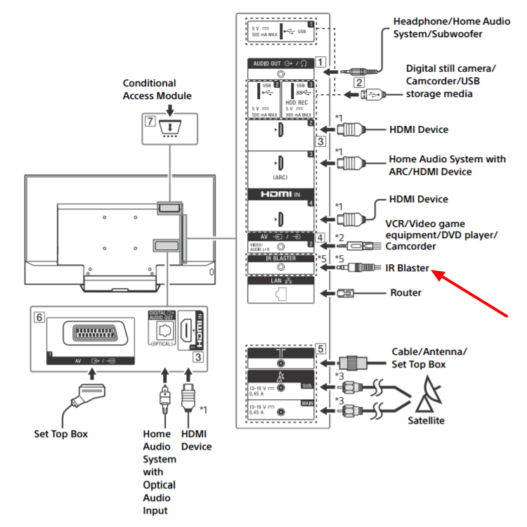

I'm focused on IR Blaster MENU but, USB? Is from an old device?
In a KD-49XD8305 IR Blaster is a mini jack input and there is only on a limited region/country/TV model.
Probably your XD94 Serie don't has IR Blaster...
XD8305 Connectors:
XD9405 Connectors:
Manolo
