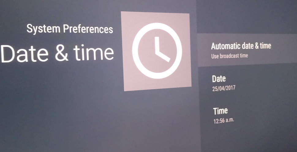

After Marshmallow Update, Automatic Time Zone adjustment is "missing" from Settings - Date & Time -Time.
The option is always fade and always set to Off. Cannot be adjusted on whatever setting the Automatic date and time is (Use broadcast time or Use network time or Off)
There is also a Generic Set time zone GMT+3:00, Eastern European Time. Almost all big Cities are missing. Strangely every time that Set time zone is selected the first available option is Midway GMT-11:00 and not present one:
This possibly causes many problems on Digital and Satellite Live TV Information and Guide.

For example, my "Automatic date & time" is set to "Use broadcast time". Going into the Time settings area, I can set "Automatic time zone" to "ON" or "Off" - it is not greyed out.
I can confirm that "Midway" is the first option when setting the Time zone. However if you look, it is GMT -11:00 and then counts backwards, GMT-10:00, GMT-8:00 then eventually it gets into GMT + values

This is when System language is set to English:
and this is when System language is set to Greek:
Translation is Eastern European Summer Time.
Athens is nowhere!!! Also Istanbul is nowhere. I believe that Turkey has same issue.
Automatic time zone remains fade even if English is selected.
