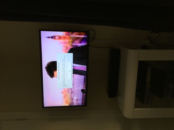

Thats OK, I don’t know what you mean either. The equivalent of what you describe here is if I asked my Samsung TV to record, and it passed the request to my YouView box, instead of dealing with it itself.
I have just pressed the Record button on the Samsung, and this happens (albeit the TV does remain upright!) :-
As a further test, I started watching the YouView box on the TV, and then pressed the Record button on the TV remote. This did absolutely nothing, although not getting the message as above was a significant change; I think maybe the TV tried to pass the request to the YouView box, which spurned it.
(And this sounds maybe like what you are trying to do, getting the Freesat picture on the TV and then recording that on the HDD attached to the TV? Wouldn’t ever work.)
So what, exactly, happens on your TV, (as @Win_88 has already asked, to no response) such that it fires up and tries to use your Freesat recorder?
