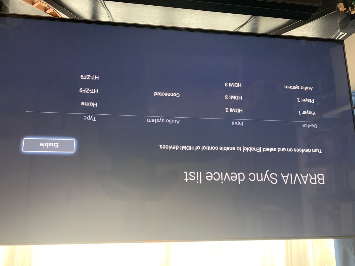

Thanks for getting back to me. For whatever reason the Bravia sync does not find the TiVo on the list, see attached image. The TIVo is on HDMI 1 and it is missing. I’ve rebooted the box, re-set the cables, but all to no avail. I’ve tried to re-do the config test - I can see the image but the TV does not find the right ‘code’ to sync so the test fails.
thanks.
I'm inclined to think that the TiVo box is at fault here since everything else shows up normally, but that doesn't necessarily mean it's faulty. Most likely the feature was disabled or something like that.
TiVo boxes are famously bad at CEC.
