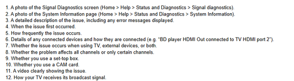

The Global suport asking me about :
but as i switched to the set-top box already, i cant provide them this easily..
