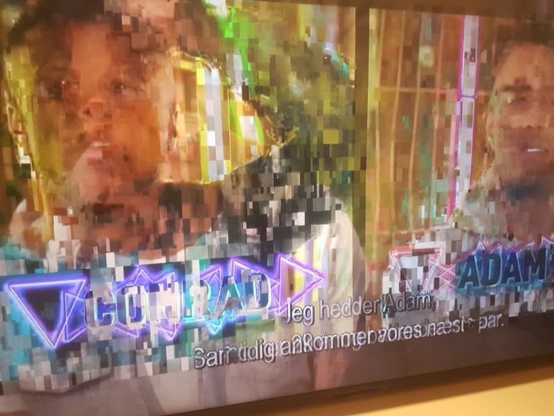

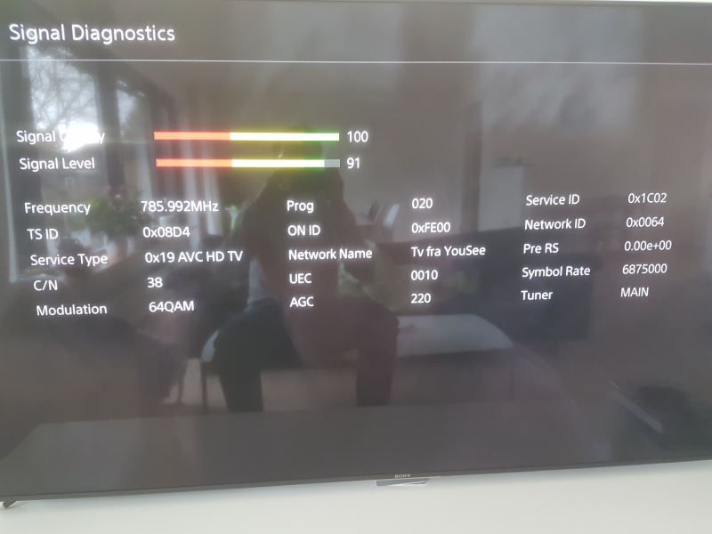

My brand new Sony 65XE9005 is badly pixelated when using the interal dvb-c tuner.
Im not experiencing any problems with my to other tv's.
I have try with an external turner, and no problem with pixelation.
The tv is pluged directly into the first point where the signal enters the house.
Is the internal tuner broken?
Photo of my tv:
What im experiencing is very similar to this: https://www.youtube.com/watch?v=mA5DBVF1zSY

In the digital tuner menu there is an option called LNA. Try to turn this off. This is known to work for some people with these problems!
