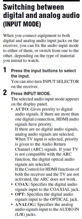

Have you checked settings on STR manual?
https://docs.sony.com/release/STRDN1040.pdf
Check pages 29 and 86 and also 99, 100, 101

@MiCal1967 - the point im making is that there should NOT be an optical cable from the TV to the AV Reciever, considering the AV Receiver and the TV can handle HDMI-ARC
@chinoko1948 - Did you remember to set the Speakers to "Audio System" when you removed the Optical cable?
