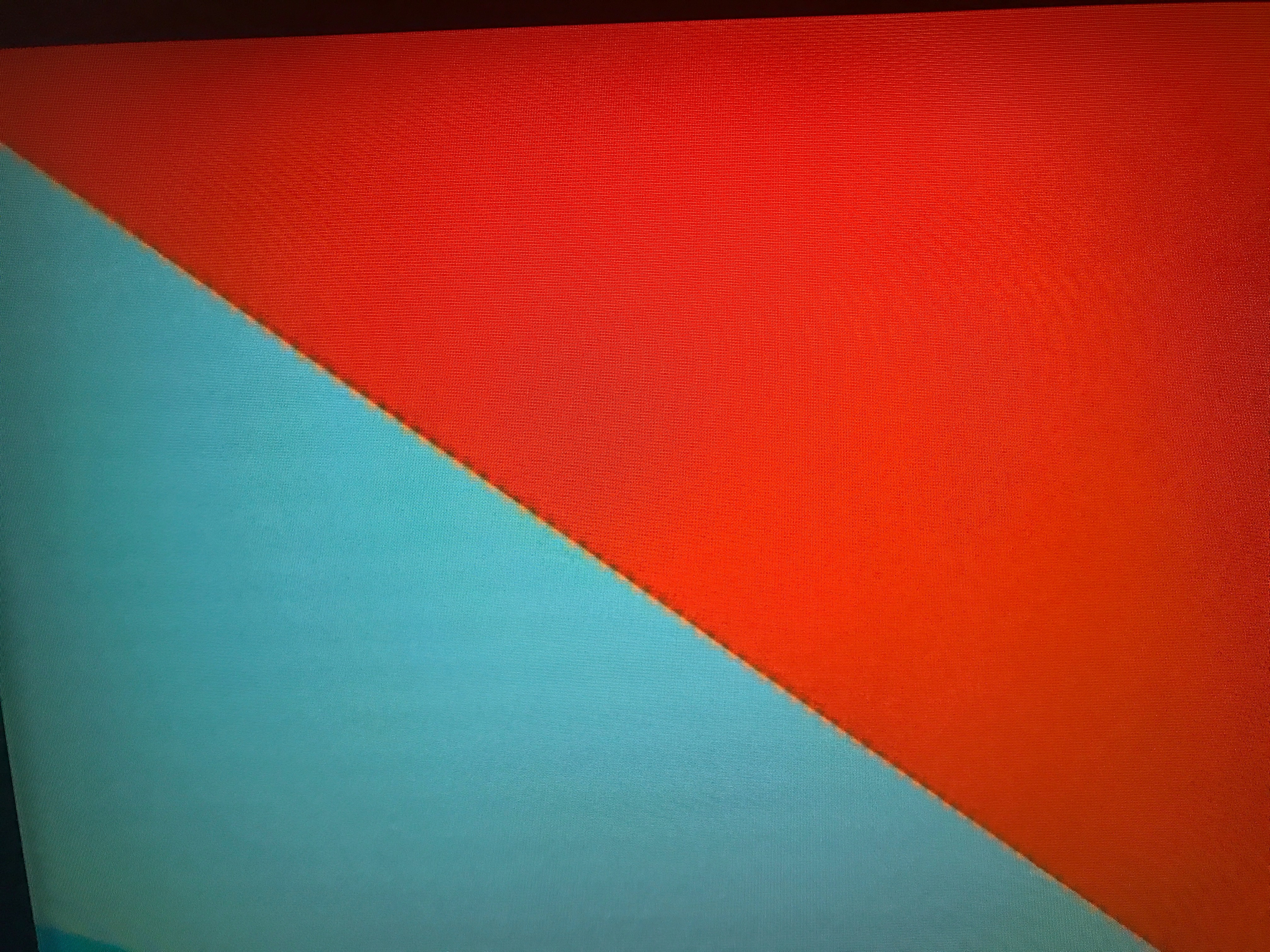

I am now in touch with the company that I purchased from for a refund. Failing that, I'm going to the small claims court. I'm also now seeing strange line block ghosting shapes on block colours that werent there before.
It's just one thing after another and £2,000 for a faulty TV is ridiculous after 3 months of use.
