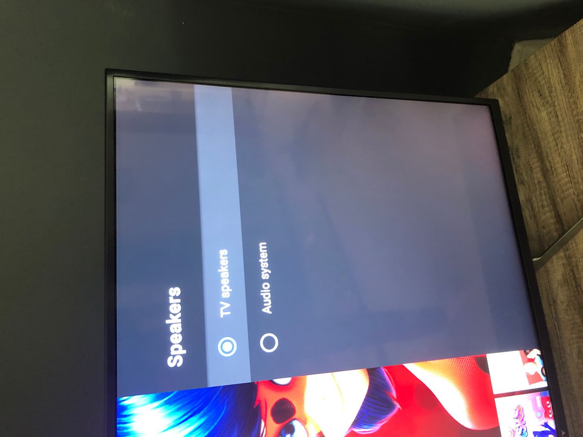

im trying to connect my sound system which uses a headphone socket, this previously worker with no problems on my old tv, but now I’m getting no sound. I can’t find any settings to enable the sound to come through that connection, the only think I can find is to direct sound through the tv speakers or sound system but when I select sound system no sound comes out.

that setting is not on my tv, there is actually very little options in the sound sections
these are what I have:
And it’s only a 5 year old 2.1 pc speaker system, probably still better than most tv sound systems to this day
Hi @andy3050uk
The TV Speakers / Audio system is for HDMI connected devices.
What is under Sound customisation? There must be a setting somewhere to allow TV Speakers and Headphones at the same time or not.
