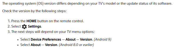

Do you have the latest software version installed? When you say reset the cache, is that for individual apps or for the entire TV through the Storage settings menu?

Your describing the same thing I was able to fix with a reset which you have tried and checking I was running with the latest version of the OS also. I've been flicking between BBC iPlayer, YouTube and Netflix on and off now for about a week and fingers crossed have not seen the issue return. We have different models so I'm not sure if the patch that fixes this has been applied to the OS for your TV. It's possible Sony haven't applied it to all models yet. Well it's got to be something like this - or I just havn't been able to break it again as yet. Fortuneltly for me this last point is feeling more and more unlikely now.
Try the OS update again. Force an update too - don't just go with the Auto detect.
