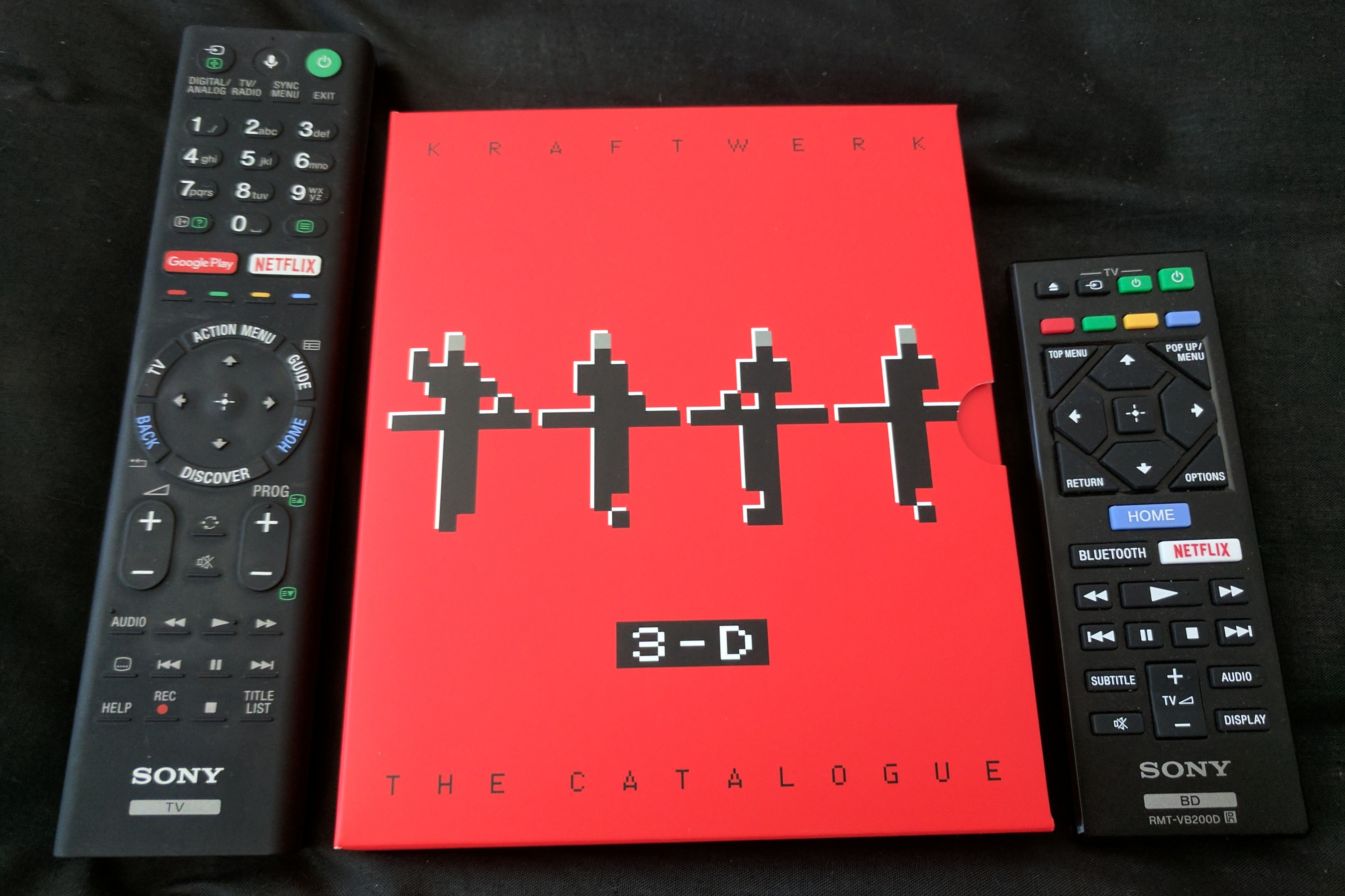

are they really issues?
well, IMO, yes they are.
i would expect TITLE LIST to be the equivalent of TOP MENU on the BD remote.
that seems to be the most obvious control the button would do when playing a BD.
it certainly makes no sense for it to bring up the tv recordings menu whilst playing a BD!
at the very least it should nothing at all if it's not meant to bring up the TOP MENU of the BD.
and for STOP, well STOP needs to be able to stop playback, otherwise how does one get back the BD top menu?
the only way i could do it with the TV remote was to chapter skip all the way to the end so that playback automatically went back to the TOP MENU.
i was playing the main content of the BD, so STOP should stop playback, just like PAUSE pauses playback, and all the other control buttons do as they should.
i don't expect the TV remote to replicate every function of the BD remote, but i expect it to perform the basics via HDMI CEC.
see photo of the two remotes, and the BD i was playing
I do not wnat to convince you, but what you expect could be not exactly what you can really have. Title list is Title list for the TV and it run a TV command. You can achieve the same function via the action menu as explained before (or evenvia the sync menu button)
For STOP it should work. On my rather similar setup (KD43XD8305/BDPS5100) it works: if you push stop it stops the playing. I do not have a very large BD collection (preferring to lease it or streaming from other channel), but on the few that I have it works as expected. But i remember on some movies that I leased playing some content (i.e. the copyright protection spot) it could not be stopped. For this reason I asked if with the same blueray in the same content if you can stop it with the BDP remote: I expect that they should work in the same way, so if one remote stop and the other no you are right
