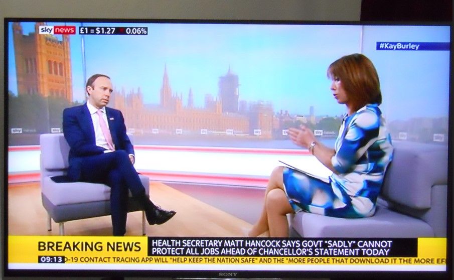

This screen shot shows the effect quite well. Notice the word and letter spacing on the bottom line of text and how it stretches out at the left and right side. The effect is smooth as the text rolls around from right to left.

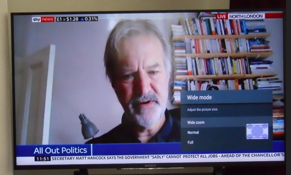

There’s an element of anamorphic in the Wide Zoom setting, while the Full is linear.
Notice how the man’s head is compressed L-R, just like the text, in Wide Zoom.
Yes, it is a bit strange in that its not fully anamorphic (to me anyway) and viewed in isolation it didn't immediately come across as wrong.
