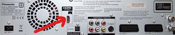

In addition to the solution pointed out correctly by my colleague @LightFoot referring to your TV manual (Page 10-11). I would like to ask you to pay close attention to the picture below and identify on the back of your Panansonic DMR-EX98V the HDMI output marked by the red arrow.
You will have to use an HDMI cable to connect the HDMI output from your Panansonic DMR-EX98V to the HDMI 1 or 4 on your Sony KD55-XF9005. Then you will need to enable the output of audio through the HDMI output of your Panansonic DMR-EX98V. For this, from the Setup menu of your Panansonic DMR-EX98V, set “Digital Audio Output” to “HDMI and Optical”.
