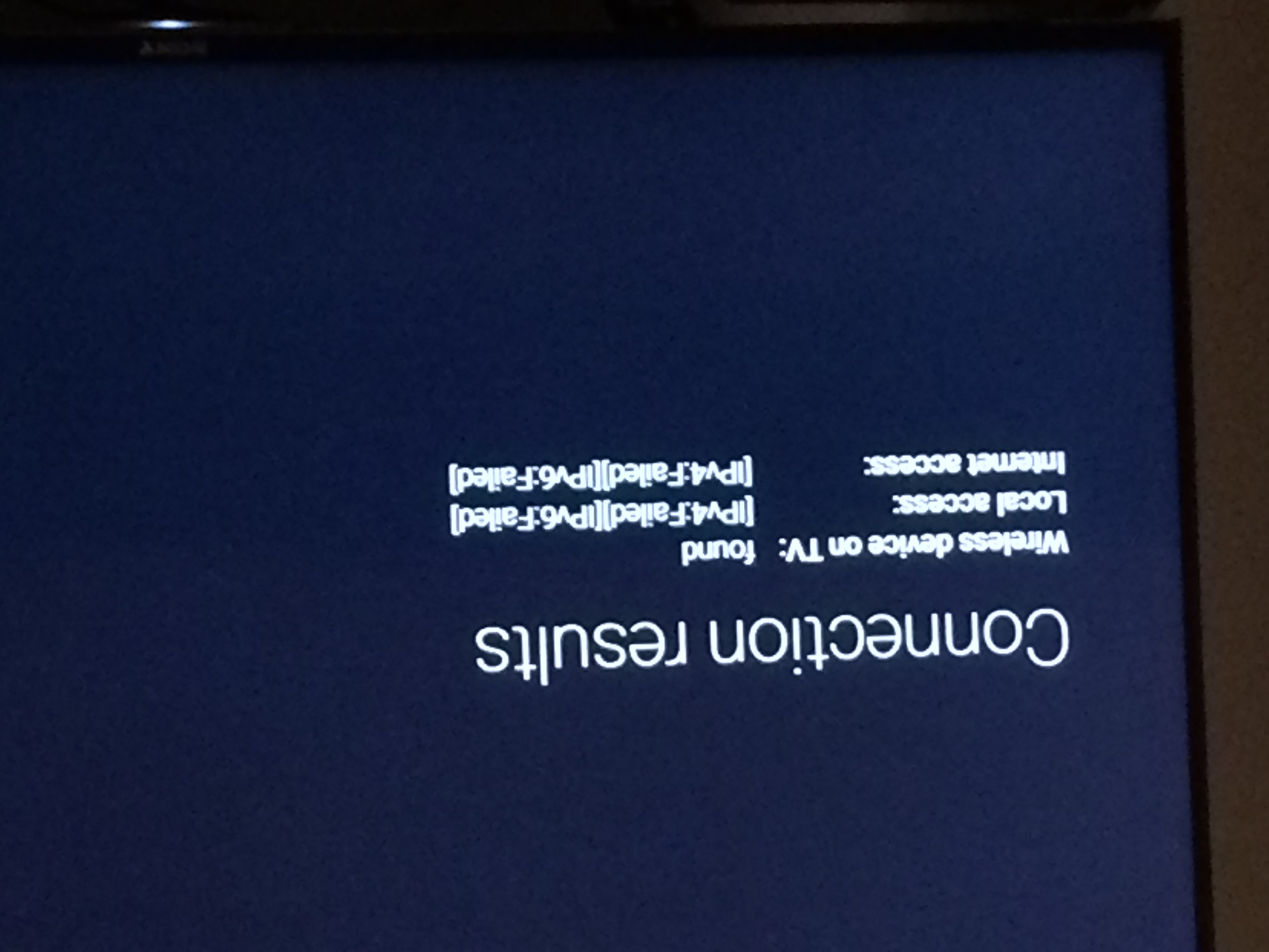

Hi. It didn't fix the problem. Now I check connection and get this error. But my wifi is absolutely fine on Xbox and laptop etc.
Hi there
It seems that your TV is not seeing the wider internet.
Can you try reboiting your router? If that still fails, can you test using an ethernet cable from the router to your tv and change network settings to wired?

I rebooted my router but it did not make a difference. As mentioned above everything else in the house is also working fine with the Internet (my Xbox my iPad and my wifi lights up and downstairs)
I don't have an Ethernet cable long enough to go from my hall to the far end of my livingroom. I should not need to have cables laying around when the tv is meant to be wireless compatible. Has nobody else had this problem?
Hi Angela
Can you confirm you have the latest firmware installed? If you are in the UK, version should be: PKG3.179.0100EUA
If so, can you perform a factory reset, instructions HERE
To me, it seems the TV is not seeing your router - wireless issue. But lets take one step at a time.
