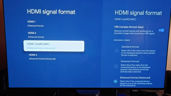

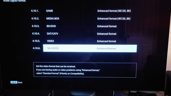

Just noticed something, maybe you could give me your thoughts on it. I'll attach the pictures of the HDMI settings. Blue background is the TV menu system, black background is the amp menu system.
The TV supports only two 120hz rated inputs. HDMI 3 eARC and HDMI 4. This is referred to as the HDMI input if you have a PS5, but as I have previously just used the game input on the amp I just stuck to that.
So, I've activated the HDMI inputs on the TV on the maximum settings. Enhanced for 1 and 2. Enhanced advanced for 3 (eARC) and 4. (PS5)
Looking now at the settings available on the amp HDMI inputs, the amp only has enhanced as available for the BD/DVD port? Game and media box are both advanced 4K 120hz. Are you not supposed to play 4K blu ray on a 120hz setting?
The available amp settings are suggesting that I plug the BD/DVD into the amp which is only an enhanced input then into the eARC. But the eARC then should be downgraded to only enhanced to match the amp output for that piece of equipment. That would mean connecting the PS5 straight to the TV like the TV manual was suggesting.
What are your thoughts on this? An eARC setting of enhanced advanced on the TV but only advanced for the amp input for the blu ray. Should this be causing the lip syncing problem?

Right....things I've just tried. I reduced the eARC to enhanced, to match just the enhanced input for BD/DVD on the amp. Didn't work. Switched it back.
I plugged the HDMI for the blu ray into the media box input. That's rated as 4K 120 like the gaming input. Still lip syncing delay with the picture.

On the TVs HDMI signal settings page for HDMI 3 (eARC/ ARC) keep it on Enhanced Advanced but switch off
VRR (Variable Refresh Rate). Restart the TV.
Now try the blu ray player connected to the amp and see if that has improved matters.
This is just an experiment to see if VRR being on is affecting the synchronisation of audio and video from the blu ray only.
