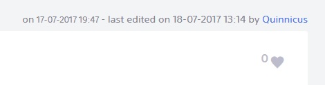

I can confirm that no one has altered your previous post.  It would have the words edited above it.
If you edited your own post, it would look like this at the top:
undefined
If someone else edited your post (if they have the correct permissions), it would look like this:
undefined
