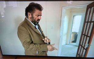

I have just purchased a KD-55A85 TV and am having problems with adjusting the picture.

It makes reference to things like 'Eco' which I cannot find anywhere in the menus. It mentions keeping the 'Backlight' setting at 7 or 8. Again, I can't find anything relating to 'backlight'.
When I look at the 'Brightness' section that appears to be set at 'Max' but is actually greyed out and so I can't make any adjustment there. The TV is only really comfortable watching whilst the picture mode is set to 'Vivid' any other setting at the moment is too dark.

Hopefully some screenshots are attached.
Here is another image. I have to add that the image of the woman is brighter in this shot than she is on the TV. perhaps that's to do with the camera, not sure.
It would seem that we have to resign ourselves to having to watch the TV with the picture mode being always set to VIVID. Any other setting is too dark for us.
My wife commented yesterday that the Samsung in the bedroom offers a far more acceptable picture than the Sony.
Honestly? I don't see anything wrong with the pics 😅 Plus, an OLED experience is always different from normal LEDs.
I would try backing off the Contrast from 100%, and see if that improves things.
The instructions you are working off, @Bluenose1940, seem to be very generic; there is no backlight on OLED, as backlight is an LED screen thing; the beauty of OLED is that it uses self-lighting pixels instead, so you never get the light bleed that even multiple dimming zones on LED are prone to.

Thank you so much for all the input folks, it really is very much appreciated.
I have finally cracked it, it was all down to a 'power button' somewhere in the menu. I turned the bloomin' thing off and hey presto, a brilliant picture.
