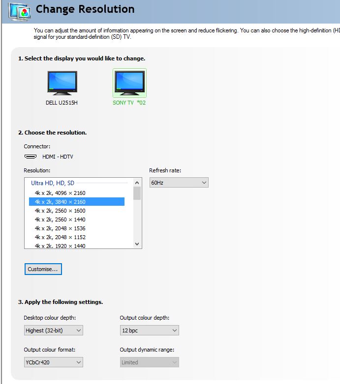

Ok so I have completed the firmware update and then performed a factory reset... No change I'm afraid.
I can output 4k, 60hz, 12 bit colour with YCbCr4:2:0 but at 4:2:2 the TV still reports no signal 😞
Here's a screenshot of my current settings.

Hi, I'm using my gaming PC which has a GeForce GTX970.
