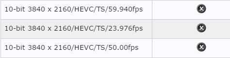

http://sony-eur-eu-en-web--eur.custhelp.com/app/answers/detail/a_id/133958

What frame rate (50p?) and 10-bit or 8-bit?

But is it 2160p50, or another refresh rare such as 24p? And at 10-bit or only 8-bit? It's a combination of 50fps and 10-bit at 3840x2160, being such a high bitrate, that's probably causing the problems. A quick Google search suggests the wetek can't do 10-bit at 50fps.
Yes I think it does 30 50 and 60fps for uhd. And not 10 bit. I presume changing that hdmi setting on the sony from normal to enhanced makes no difference on the sky and bt boxes?
People with 4K stutter, has anyone tried changing the enhanced HDMI setting under the inputs section on the TV?
