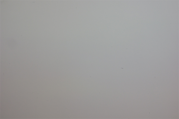

I followed an online guide where it said to set apeture to f22, set zoom to maximum, set focus to infinity and take a photograph of something monotonous (I chose the white wall inside my room). The images are very dark even though I did it in daytime and used 2 daylight lamps. I could still see the dust though. It is a very responsible task to handle something delicate, presition is required. Without anyone physically present to guide me I was very slow and tried not to put too much pressure on the sensor.

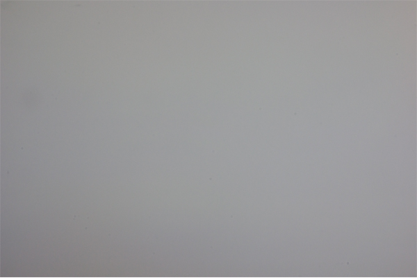

Day 1 - I used only the blower. Photo 1 is how the sensor was before I ever cleaned it and photo 2 is after many blasts from my new "Hepa Jet II" blower.
The large piece moved but that is about it with this method. Also I realise now that all it does is move the dust somewhere else for it to come back later.

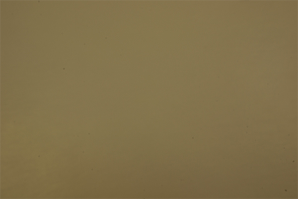

Before blower:
After blower:
