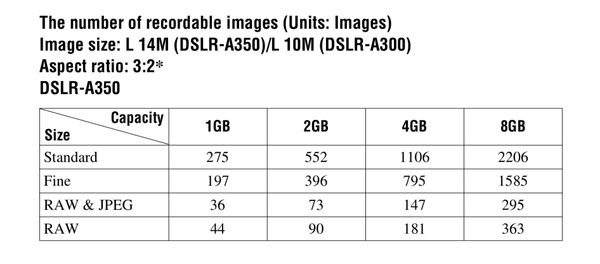

Anyway it seems that flash larger than 8GB are not supported
