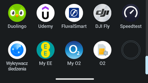

Today I realised new app icon withing Xperia Home. It is completely blank (just a shade around) and app does not have any name.
Trying to open the app or holding on it and opening more info section lead to the same - Google play "something's went wrong" screen
Tried co clear cache for Xperia Home and restarting - no result. Same for Google Play Services and Google Play.
Installed 3rd party launcher to check if it will populate this icon as well - did not. Completed full scan off the phone with Bitdefender and it says that phone is safe. Any ideas what it can be and how to get rid of the thing?

@jumpsuit it is Xperia 1 III. System has been updated recently and has security updates from May 2023.

I have the same problem with my Sony Xperia 5 III - following the latest update in May. I am not prepared to risk a loss of data currently by using the repair function, hope the issue will be rectified by a future update. When I tried to rectify the issue, the messages you encountered were identical. My phone also seemed to get very hot during the operation of trying to remove the blank app, but has settled down now after a reboot.

I have not tried yet full reset and not very keen to do it again. Just couple of weeks ago has issue with unresponsive fingerprint scanner. It was software issue and reboot was fixing it. To make permanent fix had to do full reset... Loved my Xperia from day one, but recently started hating this phone.
Relating to the icon I assume that this is some issue with the Launcher itself. Tested since yesterday couple of 3rd party apps (like Nova Launcher and Microsoft Launcher) and any of them did not have this issue. For time being stayed with one of the alternatives and quite like it.

Wonder what other app is Sony's launcher using in the background, because for me it looks like issue lays there. Yesterday cleared cache, which did not give any positive result. After tried with all launcher data, including my setting and still there was no difference (Apart of all my folders were gone and all apps mixed obviously 🤣).
On different forum seen a old thread relating to Xperia XZ and there issue was exactly like mine one and this solution apparently worked there.

Quick (but possibly needing to be repeatedly done) fix:
"Try disabling play store, then long press on that app, it should disappear. Then enable play store again"
Possibly permanent (but need to backup all data first and set phone up from scratch again afterwards) fix:
