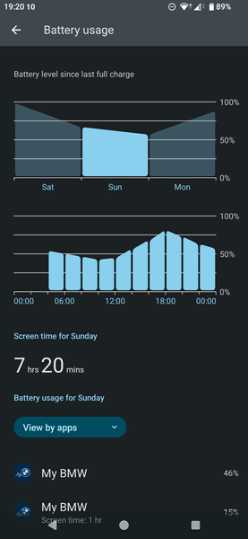

Hi I've just got an Xperia 1 vi but I've noticed the battery usage monitor is not working is this due to the android 15 update? I updated all the patches before I set the phone up to use.

I found another user who was experiencing the same issue he suggested deleting the app data and cache for the settings apk.
This has helped somewhat but it is still showing strange recording behaviour.
