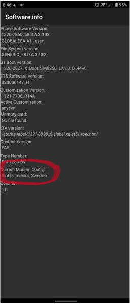

And here comes the curious part: when I go to Software Info in the Service Menu (*#*#7378423#*#* > Service Info > Software Info) I see that the Current Modem Config is Telenor_Sweden.
This is totally incorrect in my opinion and probably has much to do with the network problems of the phone, because Telenor Bulgaria does not use the same set of 4G frequency bands as Telenor Sweden, which renders the handset unable to find the frequencies it expects. If I put a SIM card of another Bulgarian operator (A1, Bulsatcom) into the phone, the Current Modem Config changes to ROW_Commercial.

Unfortunately I still have this problem. The service center which services this model has proven unhelpful and unwilling to cooperate so far. My device was replaced under warranty and the new one behaves exactly the same. I've noticed that when a Telenor SIM card is in the phone, a wrong modem configuration is applied and I had written a detailed post in this thread with some technical details and error logs, which was deleted very quickly without explanation. My theory is that the carrier policy is wrong and gets confused by the similar carrier names, but how do I find a knowledgeable person to explain this to? If you are interested in taking some collective steps towards resolving this, please contact me.
