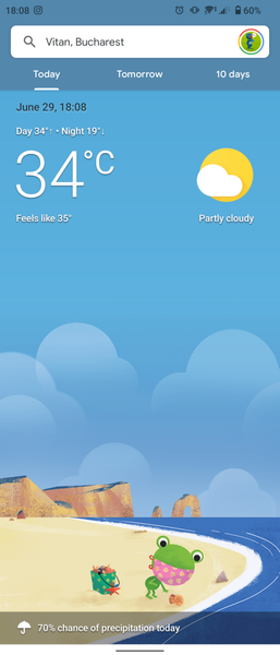

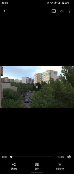

Just did another test.
Settings: Videography Pro, 4K HDR @30 fps, seamless zoom, stabilization on, everything else on auto, screen with high refresh rate OFF
Conditions: outside, cloudy but very hot at 35 degrees C, handheld.
Filming duration until app shutdown: 13:09 minutes.
